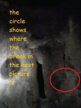

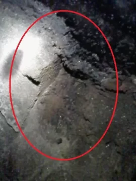

I cleaned out the boiler of ash, etc. and for some reason I found that the cement(?) that angles toward the nozzle is breraking off in huge chunks. What is going on? Is this still safe to use? Can I replace this? Do I NEED to replace this?
To answer your question I'd say that you probably should replace the refractory if there are "huge chunks" missing. The bottom of the fire leading towards the nozzle will be the hottest part. The cement is there to protect the plates below which are not designed to withstand the kind of temperatures the cement can withstand. So ultimately it's there for a very good reason and in my opinion should be replaced if compromised.

Although I didn't have huge chunks missing,my nozzle looked a bit worse than yours. About $12 in firebrick and another $10 for a diamond blade for the angle grinder and you're back in business. I didn't cement them in place or anything,cut them so they fit nice and gravity holds them in place. It lets everything expand and contract at their own pace.
On another note,and taking a cue from ewdudley,I played with the opening length of the nozzle by moving the two narrow pieces of new firebrick in a small amount. In effect adjustable btu output? Fan speed had to be adjusted but nice flame and reduced output which is ok for this time of year.
I believe the original nozzle is cast in place? Anyone else know? Don't know about curved pieces that surround the nozzle.
