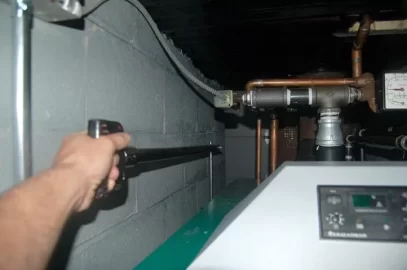

If you have a new EKO, it should have the handle on the left side. That's the heat exchanger tube cleaner. Pull it back and forth a couple of times each time you fill the boiler with wood. I bolted an old snow shovel handle to mine so that I can operate it from the front of the boiler. I'll post a pic if I can find it. Anyway, that pretty much keeps your heat exchanger clean. You're supposed to take the thing apart once a year and brush out the tubes, but I didn't this year. We'll see how well that works.

  • [Hearth.com] EKO 40 getting close, have a few question
