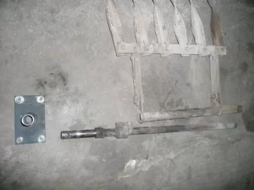

I have the cleaning handle also but I still take the turbs out and do a good cleaning monthly.

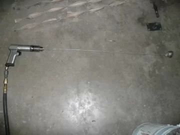

I use a cup shaped wire wheel fastened to a steel rod and chucked in a drill.
It does make a difference,the cleaning handle attached to the turbs only does a marginal job IMO but the wire brush cleans them nice.
I always see a drop in flue temps afterwards.
It is a pain getting the handle shaft out the first time but once you figure out how it all comes apart its not to bad.

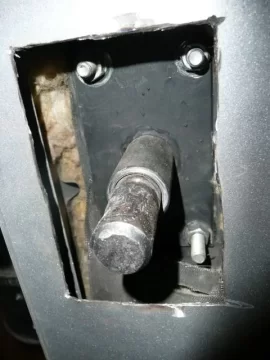

I did modify the outer sheetmetal skin on my boiler to allow access to the bolts that hold the turbulator shaft in.That helped alot.
