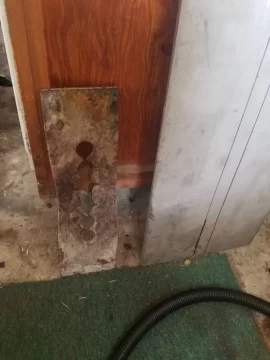

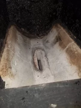

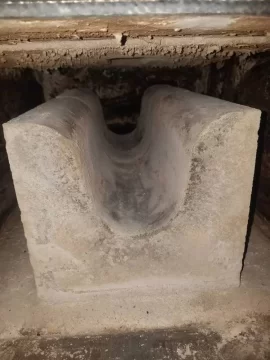

Every year I clean and inspect the boilers. I've been using a nozzle protector made out of stainless steel since day 1. There's sone wear on the nozzle itself, but will be able to get a couple more years out of it. The U shaped refractory pieces in the bottom both cracked at the end of last year, but still are useable. The heat exchanger tubes only get sone fine ash in them that are easy to sweep out. No creosote buildup at all. Same with chimney, I only get maybe a half gallon of dust out of the entire chimney. So it's been running about as efficiently as possible for my setup I believe.

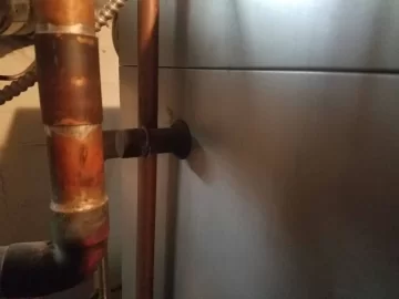

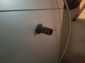

Also what are the 2 3/4" pipes sticking out of either side of boiler? They said to just cap them so thst they can vent and not build pressure. I wanted to add a way to heat up my domestic hot water with the boiler and didn't know if that is what those pipes are for.
That about sums it up for now. Heres some pics of pipes I'm referring to and a couple others. Thsnks again mike [emoji4]![Eko 25 update and ??s Eko 25 update and ??s](https://www.hearth.com/talk/data/attachments/199/199936-62c4fa6b72e84c7875d8d1ecd684b503.jpg)
