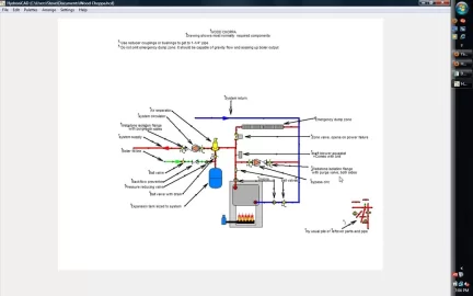

Maybe this will clarify things a bit for you.......
I seriously can't give you lengths of each piece of pipe or the exact fittings you need. Neither can the manufacturer. I can however, tell you there is no such thing as a one stop plumbing job. Plan on a few mistakes and Ooops along the way.
Never forget that you are dealing with what is technically called a "pressure vessel". Things can get very ugly, very quick if one of the safety's fail or it is not installed correctly.
Also keep in mind that this is not a one day project for a Do It Yourself type installation. It wouldn't be a one day project for me for that matter. Probably more like a week by the time you are done. Sounds like it should be simple at first glance.....customers say to me," How come it costs so much? It's just a bunch of pipe fittings and nipples........" Right. Remember that you are assembling a system and not just a bunch of pieces and parts. That my friend requires a lot of forethought and planning. That's why I get the big bucks ........Riiiiiight.......... Har HAr HAR
The diagram I have drawn for you here shows various components in "ladder" form. How exactly they have to be configured is going to be dictated by the circumstances of each job. That's always the way it is. I have never had an installation that was the same as something I had done before. Same components and boiler but never the same layout. That's what I mean when I say I can't give you a list of fittings and have it be correct for your particular job. Econoburn as well as every other manufacturer out there knows this too.
Make sure you install enough heating capacity in your dump zone to handle a worst case scenario. It absolutely must be able to gravity flow. In other words is has to be higher than the boiler. If there is one thing that has to be done without cutting a corner, it's that. A runaway fire in a wood boiler is something that a person will remember for a looong time.

heaterman said:
....Make sure you install enough heating capacity in your dump zone to handle a worst case scenario. It absolutely must be able to gravity flow. In other words is has to be higher than the boiler. If there is one thing that has to be done without cutting a corner, it's that. A runaway fire in a wood boiler is something that a person will remember for a looong time.
