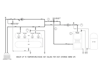

Thought I would start posting some pics and info on my installed system which has been working very well for me. Still have some insulating to do but other than that its complete. The PID is of the boiler room piping, my boiler is in the insulated half of an exterior woodshed (16'x20'). I have insulated 1" pex supply/return lines that travel 50' through 8" corrugated pipe underground to my basement.
Happy with the econoburn, but I would not be happy with it in my basement without very good draft or a draft fan... it can be smokey. The storage is also very nice, I can use programable t'stats and wake up to warm floors!

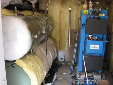

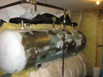

Some pics of the tank install, they are hard to make out but there are four hot water heater elements and four t'stats installed in the upper tank, I will get some pics of the radiant floor manifolds up later this week... they are a work of art, custom made using honeywell zone valves which will be available 40yrs from now! Unlike many other manifold valves which change every 5 yrs.

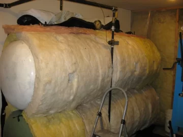

couple more pics, closer to finished product

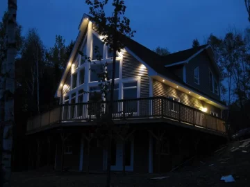

The house I heat with this system has some big heat losses on its southwest exposure as you can see from the pic, twelve months to build the house and 10 months to get the heating system (almost) fully installed, the price of doing things yourself!

Some weak points of this system are that you loose stratification in the uper tank a few hours after the boiler shuts down if the house is calling for heat. Also getting hot water from the lower tank is reliant on convection currents flowing through the two pipes conecting the tanks, one carries cooler water to the lower tank bottom, the other lets hot water up into the upper tank. These convection currents are not as fast as the house heating demand and therefore the upper tank can at times become cooler than the lower tank. Not really a problem as eventually the house stops calling for heat and the upper tank heats up again. There are definitly better set-ups available but this one fit my needs, budget and space constraints. The thermostatic valve for boiler protection is also undersized (1"), but it was such a good deal on ebay! lol with a larger one I could have a smaller delta T between my boiler supply and return temps, but its acceptable the way it is
