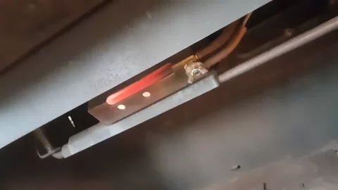

Solved! This was so hard to diagnose because it wasnt just one thing wrong but two at the same time. It was both the controller and the vacuum switch! This is why jumping the switch didnt help the first time. My heart sank when I put the new controller in and it still didnt work. It was when I followed diagnostic mode instructions which came with the controller,I figured out it was also the vac switch. With the old controller in, jumping the vac switch doesnt get the auger going, so that proves its both parts that failed. I know its an old stove but I hope this thread can help someone.
