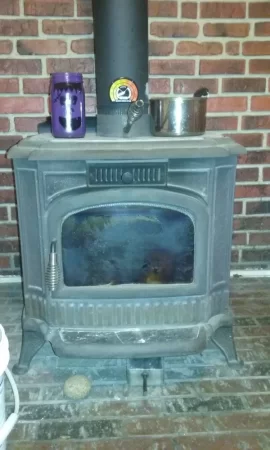

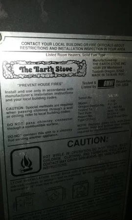

Hello im new to the page. I'm a tree trimmer by trade so i have an unlimited supply if wood and i just bought my first home. it came with a earth stove. I grew up with a fire place insert and a wood stove so i have a firm grasp I how they work, however I'm having trouble gettkng this stove hot and i can find little to no info on it. The problem is, loaded with the door closed it is nearly impossible to get the thermometer above 200 degrees but with the door cracked 350 is no problem. Does anybody have any information on efficiency or btu output? Any suggestions on why i am having problem getting it hot with the door closed?
- no ash tray
-draft control is above the flame
Heres pictures of the stove

your referring to flue temp, and your meter is pretty tight to the stove too. i would like to know what your stove top temps are though. 200 at the flue is certainly too low, my earth stove flue would be at 400 and my meter is another foot or so above yours. my stovetop runs 750-825 with a good cat burn, and i'll put a fan on her if she starts creeping up. i would do a good clean out, check your chimney for any obstructions, shop vac out the stove (with a bag in the vac), follow your air control and check for any obstructions. at the end of the day it is likely your wood supply though.... cut/split/stacked in your garage for "a few weeks". not a chance its ready, even standing dead. i'll cut standing dead this winter with the plan to start to burn it next winter. get some dry wood from a friend, or grab some eco bricks and give it another try. then you will know for sure.
