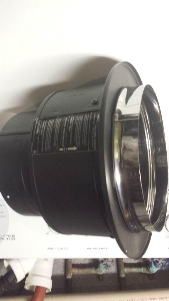

My top section is an adapter that increases 6" Dvl to 8" chimney. The mounting ring that screws into the ceiling box covers all of the vent holes of the 8" DVL to 6" DVL adapter. So any possible air movement out of the space between the walls is sealed shut. The bottom of 15' high, 6" dia. DVL at the stove adapter is open, so air could enter and flow up entire length, between the walls, but it cannot leave due to being covered by the mounting ring. If it does not have to breath then I am good, but if it does I will have to ventilate somewhere at the top.

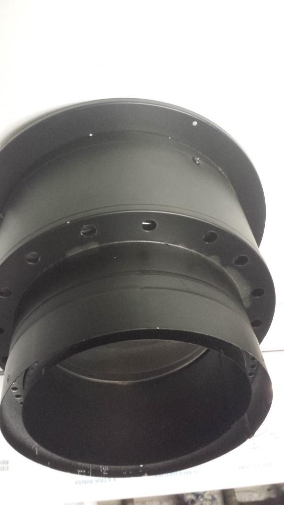

Thanks! The 8" SS chimney adapter ring only overlapped the inner SS pipe in the 8" DVL part of the 8 to 6 adapter by a little over 1\4" , leaving too little to establish a reasonable gap for venting. I used 1 inch tek screws and flush fit the chimney adapter ring. The area where the adapter flares from 6 to 8 inches, about 4 inches down, is about an inch wide, and I took a drill and perforated a nice circle of holes around it. I will edit and upload a picture.

Still trying to upload a photo, maybe post count is still too low, or Photo is still too big, I will reduce it again and give it a go here.
Whoa! Those are Real big, my apologies, but a picture is worth a thousand words they say......! Thanks to all here that have helped, a great resource! I think the mods to the adapter above will work....or burn down the house.
