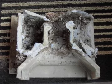

bsa0021 said:If you had the flue cleaned by an incompetent sweep, they could have run the brush through the refractory in the back. You should not have a hole directly under the flue collar when you remove the top. Note:There will be two openings toward the outside edge of the refractory.
You might want to check with your dealer to cover the cost of the fountain. These were orginally warrented for the life of the stove. My dealer listed my stove as a newer model failure thereby replacing it under the "new" company warrentee.bsa0021 said:Engineer2: You should not be able to see light as you describe. It sounds like the enclosed chambers inside the fountain have disintegrated. My fountain was toast after 3 years of 24/7 burning (see photo). Do you have flaking material above the shoe? Before you buy another fountain, make sure you don't have cracks around the bypass door as I did.
Hanko said:bob, there are two things you have to keep track of. take the top off (two bolts from inside) there are two chambers that run down on each side. you have to get a small vacuum attachment to get down there and clean it. Also if you let the ash build up to high, that interferes with it also. Despite what some of these people say, its a great stove. You just need an IQ above 50 to operate it which there is a lack of around here
