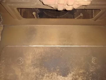

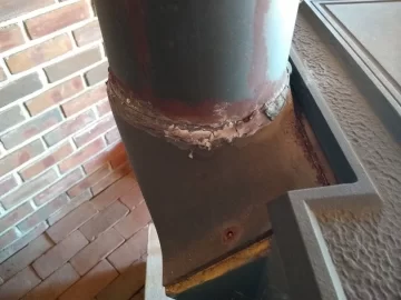

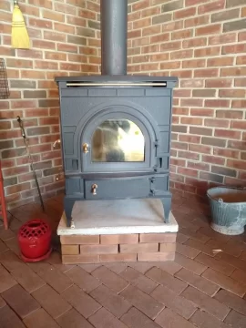

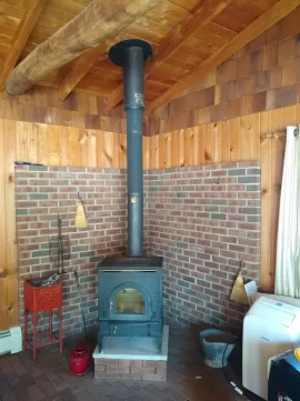

Couple pictures of the setup attached. Any advise is welcomed! Thanks...

Just inspected the stove a bit, I don't see any buildup of dust. I don't see any plastic stuck, I did notice that the stove pipe connection to the stove adapter has what appears to be some clear silicone along with some cement that is flaking off. Not sure if that could cause it. I just started another fire, want to see if the smells comes back again. I will report back shortly.

The stove pipe and adapter connections should not need sealing (b/c draft should suck air in there, and it should be tight enough to not suck in too much). Moreover, for a (hot) woodstove, I'm not sure silicone sealant is appropriate (for cooler flue gases of pellet stoves I have heard it used).
I cannot identify the stuff at that seam, but it should not be necessary. Are there (3) screws holding things in place?
Also, is it possible to use a funnel to see if the smell comes from that location rather than from elsewhere (if it re-appears)?
The smell is appearing again, but doesn't seem to be as strong as last night...I also have the windows open so that may be helping......I tried to smell around the stove to pinpoint the location and I'm not having any luck.....
Considering that joint shouldn't need to be sealed, I think I'm going to peel off the "silicone" and see if that changes anything....In the picture the dark stuff is cement, the light is silicone to the best of my knowledge....
Given that we don't know how big gaps there are, try to leave the cement there for now when you peel off the silicone.
Silicone definitely does not belong on a flue collar. Clean it all off. If the gap is >1/8" stuff it with some flat fiberglass gasket material. If > 1/4" use stove door rope gasket.

Pick a bit of that silicone/furnace cement out of the way, and see how much of a gap there actually is. I don't seal my flue collar connections; I rear-vent both the Keystone and the 2460 into a tee, and the tee snout fits fairly snugly into both collars. As begreen said, gasket material will work for larger gaps, but I doubt you have that much.
There's a lot of rust around the flue collar; Could be from summer condensation of warm, humid air in the cooler pipe and stove, if they ran AC in the summer. I cap the top of my liner in summer, and I think it does reduce condensation.
Actually, condensation may have rusted out one of the two screws that hold the flue collar to the stove; It appears that the head is gone from the one that's visible in the pic. :eek: Does the screw on the opposite side still have a head on it?
There is a gasket under the flue collar that seals between it and the stove body. I always use OEM gaskets, that way you are assured that you have the correct density and material that the stove maker wants in there. Search "dutchwest 2460 gaskets," and all the usual suspects come up; woodmanspartsplus, stove-parts-unlimited, cozycabin, hechlers, blackswanhome and so on.

Here is a pic of the nails, looks like they are just laid in there to let some air out? Not sure what's up with that...
That's an odd one. Maybe the turbulator or cat was plugged and the stove was spilling smoke. They certainly don't belong there in a properly running stove.
