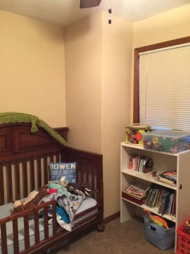

Question, is there any need to insulate a chase that is indoors? And if so, what do you use? I assumed insulated a chase was a no no code-wise but I've read elsewhere on here that guys have done it for outdoor chases.
Mine is inside a bedroom. I haven't looked yet, but I bet the inside of this is not insulated.
no need to but you can and can use any insulation as long as you maintain the clearance requirements.
