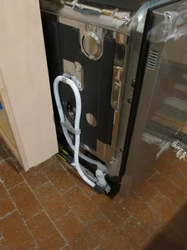

Trying to install this new KitchenAid dishwasher ... The drain hose is clamped to the left-hand side of the unit (see photo). But it kind of looks like it's designed to be able to be unclipped from those clamps so it'll reach farther (like to a sink cabinet on right-hand side). But only the top clamp looks like it comes loose easily. Confused.

Its clamped that way to prevent it from draining when its not supposed to. Just like a clothes washing machine. It an be unclipped as long as the that much height is maintained.
Reactions: semipro
Mine too, and I unclipped it upon install. I ran up to the sink air gap under the cabinet beside it. The OEM hose on these things is super short so they include a lame extension.
The instructions will be very clear about the need for an air gap or high loop.
One more thing. I bought and installed a three sided plastic pan for the dishawasher to set in. I LOVE IT!! Dishwasher leaks are the silent killer and with the pan I know that leaks will be routed out front where I can see them before serious damage occurs.

you need to keep a loop if you take out that loop the sink could drain into the dishwasher especially if you have a disposal and what a stink. and if not noticed that stink water will come out onto the floor.
