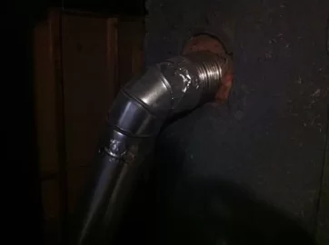

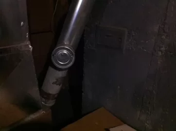

We put a PE insert into our existing fireplace two monthes ago and haven't used oil since. Love it.
We have been offered a second stove and want to put it in the basement and use the existing flue to vent it. Here's a couple
Of pics to help illustrate what I'm saying [Hearth.com] Duel purpose  flue[Hearth.com] Duel purpose  flue
That piping vents our oil
Furnace, have you any information on having a duel purpose chimney that can vent both oil and stove?
Thanks.
MOE.
Don't know where you are but most areas do not allow more than one appliance per flue. I definitely would not do it if they used different fuels. Are there any unused flues in that chimney? Have you considered running a new flue (class a in a chase or outside)?
