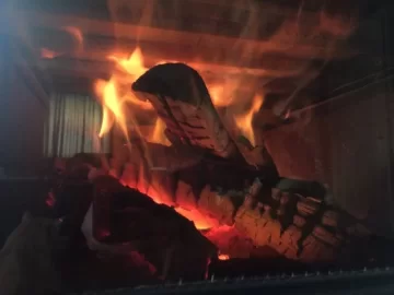

Here is some serious secondary performance.

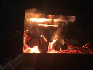

That was a compressed wood product, NIELs I think. So pretty much perfect conditions for good secondaries. Dry wood would do the same, but not with the blue flame. Here is one of cordwood burning in the T6.How much wood is in there at the time? I can’t tell from my phone...

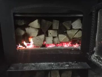

I now load like this:
The wood lights before I am finished loading it and the stove top temperatures climb above 500 degrees within 10 minutes. As the entire load ignites it starts to shrink leaving more space at the top which facilitates the secondary action. I find that if there isn't space up at the top the secondary action has difficulty getting established.

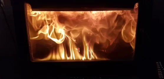

I am dealing with less than ideal moisture content and to combat that we split the wood smaller than I would otherwise prefer - almost kindling sized. This helps it dry out a bit as we lay it out on the hearth to warm and dry in front of the stove before being loaded. Each load gets a warming/drying session as long as the heating cycle preceding it. I also load the stove north/south most of the time unless I have east/west splits that are very well dried. Just now I loaded the stove in the above pictures the stove achieved over 600 degrees in 11 minutes and the wood was hissing as the fire built in intensity. Here is a picture of the secondaries when we closed the door and closed the damper.
Letting the stove run full bore on small splits to high temperature and then closing the door and damper seems counter-intuitive to long burns but it is the only way I have found to ignite the secondaries which are absolutely critical for long burns and good heat.
