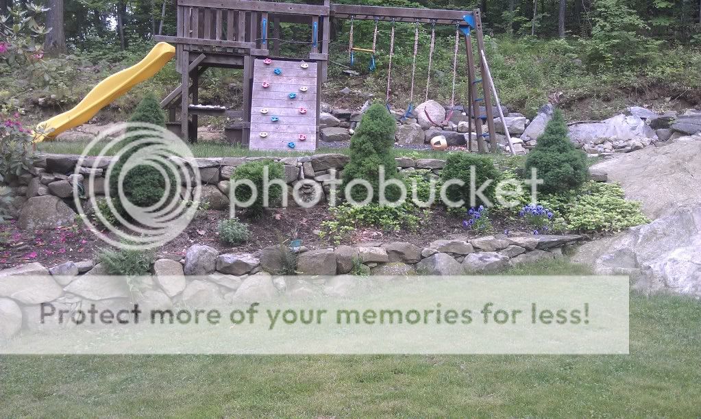

Here are some photos of my dry stacked walls and misc stone piles. Some walls are more for looks and some are rougher/living walls with ferns planted in...
PS...I live on 'Hillside' Drive so doing my landscaping in tiers was kind of a must...
