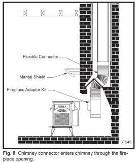

I'm hoping to get some advice on installation of a stove (VC Intrepid 2) in a masonry fireplace. More specifically, I am interested in hearing about your experiences with running the stovepipe into the terra cotta section without use of a flex liner.
I had assumed id be installing a steel plate to seal off the chimney from the fireplace with an allowance for the 6 inch stovepipe to plumb into it, but I'm not finding any products made for this purpose. It seems that by and large, folks are installing the soft flexible liners from the stove all the way up to the top of the chimney. Often this seems to mean ovaling the liner at the damper.
Can someone sell me on why i shouldn't use my perfectly good flue with terra cotta liner to vent my stove?

1) The flue area shouldn't be a lot larger than the area of the 6" flue pipe, especially if the chimney is less than 16'. It will weaken draft
2) Normal stove pipe is not allowed, it must be stainless and you will need flex to get past the damper area. A short length of liner can be used with a block off plate but...
3) Crud is going to collect around the stub of pipe every time the chimney is cleaned unless the block off plate is removed when cleaning (which would be a pita)
So reduced draft, a dirtier chimney, and incomplete cleaning are what can be expected.

So over double the recommended size...28.26 sq in. on a round 6", 8 x 8 is 64 sq in...that WILL affect draft. (not in a good way) AND, square chimneys like to build creosote in the corners...and it can be harder to clean out.
Plus, the chimney pros say that 99% of masonry chimneys don't meet clearance to combustible codes anyway...or at least no way to verify if they do or not. For me, when the stove is running, I sleep better having the fire isolated to a nice insulated liner...
No disputes with your cross sectional area math. I am curious though what makes you say “recommended size” as 6 in dia. The manual for my stove very clearly states it recommends either 6 in round or 8x8 square.

I believe what you are referring to, is called a positive connection to existing flue. If all your dimensions fit the manufactures specs with this type of connection I would say it would probably work. However, if you’re already installing to first flue tile from stove, why not go another 15’ ish to the top and reap all the extra benefits a full liner will give you? Peace of mind and you could start cleaning liner yourself and save that money too. It takes maybe 15 minutes max and you can clean as often as you like to give you added peace.

This is not a slammer. That term only applies to inserts where the sealing is done at the surround. They are no longer legal. Berl2169 has it correct. The OP is asking about a positive connection. This is covered in the stove's manual.
Drop me a liner? Wood Stove in a Masonry Fireplace
The problem with direct connects is that all the instructions i have seen call for a positive connection to the flue tile. I have never seen one that was attached or any way to attach it.
