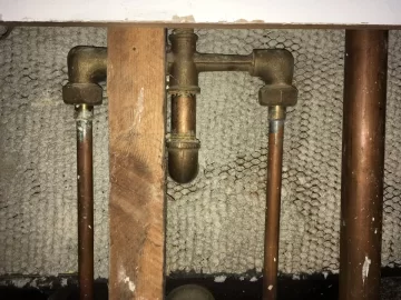

The bathtub faucet has been dripping for some time now. It's an old (1960's) two handle model. I've tried replacing the washers and putting in new valve seats. Still drips and getting worse. It appears to be the hot side.
My plan was to open up the wall and pull out the faucet and replace the faucet body. I really don't want to do any tile work on the tub side, if I can avoid it (planning on a full remodel in the next year or two). The backside is in a closet, and on close inspection my wife found an access panel hidden behind several layers of paint. Problem is that there's a stud running just off center of the faucet (see photo). Since this is the back, hot is on the right.
Any ideas, thoughts, or suggestions on getting this bugger out? Or on solving the leak problem without taking it out?

Cut the stud, change the faucet and sister a new stud in with screws.

Hmmm... let me look into a faucet grinder. Anything I can do to avoid cutting it out would be good.
As for sistering in a stud, there isn't room on either side for the sister to fit without notching 3/4 of it out - the cold water is on one side and the control/shower part is on the other. I might be able to insert a piece like a dutchman, and then use plywood on either side to hold it in place.

I have the same hokey stud right beside the two faucet valve too! They actually attach the shower head to the side of the stud. It's right in the way for modern plumbing if you want to center your handle, spout, and shower head.

Turns out it was a quick fix, and I didn't need a plumber - just a wack upside the head. When looking at some YouTube videos, I realized that I hadn't put any pipe tape or joint compound on the valve seats, when I replaced them originally. Took it apart, put a good winding of tape around the seat, tightened it nice and snug... problem solved. Though I do feel a bit stupid to have neglected that the first time around.
