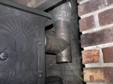

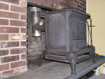

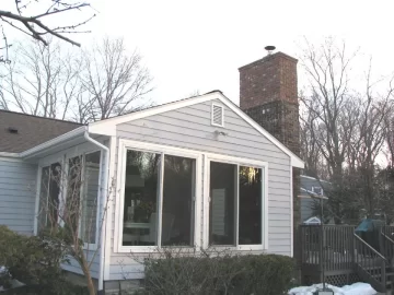

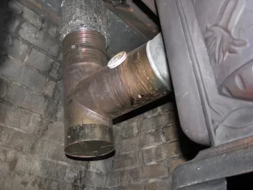

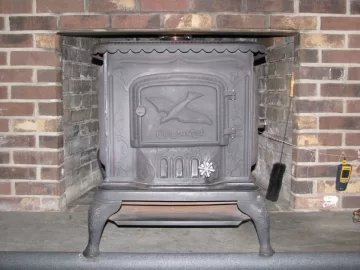

The 16 foot stainless steel flue liner with the 7 inch oval outlet on the Comforter stove. Updraft still insufficient. Stove has puffed back a couple of times and left soot all over the house. My wife is angry and does not want the stove lighted again. I have posted some pictures this time. Hope someone has an idea.
