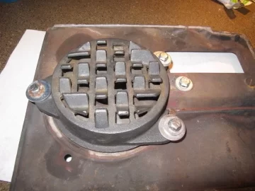

Hi there. I am new to this forum and apologize if I am in the wrong place. If I am, please let me know where to post.
Basically, my brother game me his Dovre 300H wood burning stove and it's in great shape but needs some TLC. So far I've painted it, brazed a couple broken parts and will be replacing the gaskets before the cold Boston winter arrives. I did notice one part that I don't think I can fix. It's stamped with HL 100/01 and is attached to a larger part HL150. I'm not sure what this part does but it looks like it may help in re-burning smoke to make it more efficient. I'm having a heck of a time locating this part and was hoping someone has one to sell or can point me in the right place. I've done google searches and searched this forum but no luck as of yet.
I've attached a photo of the part I'm looking for and the progress of the rebuild. I've grown up with wood burning stoves and always imagined I would have one when I bought a house. Well, the time has come and I hope to heat my shop this winter.

Hi Pete, welcome. Nice stove, but I suspect the chance of finding this part are slim to none unless found in a used stove or overseas. Where is that part located in the stove?

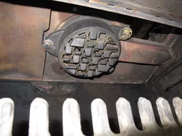

Thanks for the quick reply! The part is located inside and towards the top of the stove. There looks to be a 2-3" space between that part and the actual top of the stove. It separates the main burning area from the top. I've attached a photo taken at a worms eye view, pointing up looking into the main chamber to show you what I mean. Any idea what this is for? Is it not needed? ;-)

Yep, looks like some sort of turbulator with possibly a secondary air supply being introduced by the pipe coming in on the right side. From it's condition it looks like the problem was it got too hot.
Is that the only exhaust port or are there others? It seems very small for such a big stove.

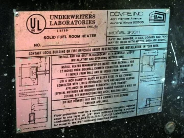

FYI... I attached the back plate with model info from my stove. Looks like parts may be interchangeable with a few other similar models. Thanks.

Good to see the label. I'm guessing they made a cat (300HC) and a non-cat version (300H) of the stove. Honor those clearances. It looks like this baby can put out a lot of heat.
It is possible this part was used in other models like the Aurora, etc. Your best bet may be to contact Dovre directly:

wow.. I got an email back from Fran at Woodman's Parts Plus and he may have the part!! Or something close enough that I may be able to modify!! See link below and image.
I'll keed you posted with the preliminary results once I take better measurements. Pete

Well, the new baffle part came in last week and (drumroll) it works!!! I had to do some basic milling/grinding to get it there but the build on it is MUCH more solid/thicker than the original. The main problem was that the inside diameter was considerably smaller than the original; so, I had to spend a couple hours with an angle grinder to make it fit. (working with cast steel is a B**ch! :-) Also, I had to drill mounting holes in different locations because they did not match up and expand the airflow hole a little as well. Luckily, things were on the smaller side so I could expand to fit, rather than the other was around.
Below are some pics but overall, for $30 and a few hours work, it was well worth it! Now to install the new fiberglass gasket rope, seal it up and I'll be good to go for the winter! Thanks for everyone's input and the folks at woodmanspartsplus.com (Fran in particular) for spotting this elusive compatible Dovre HL100/01 part :-P Pete

Looks good Pete. That is the way I had visualized it working. Nice job. Is there a gasket seal around the base?
When you start burning, please come back and post more about how this repair works out and how the stove burns.
There is no gasket there but the joint is very tight. I may put some high temp sealer there but it's 10x better that the old one, so may just leave it at that. Thanks for the help/input! -P
