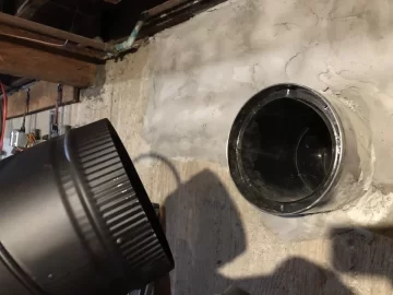

dude to clearance issues I am going to run double wall into my class A chimney pipe where it goes thru my basement wall.
Which adapter do I need for this? I have been looking online and see “adapters” but I am not sure which one to get.

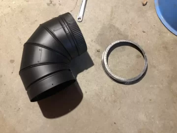

I have the double wall and some type of adapter ring that came with the pipe I got from my friend.
This maybe but it looks backwards
