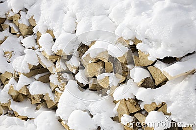

does wood season in winter?
Uh, it depends,,,,?
[Hearth.com] does wood season in winter?
Hey kiln drying by the stove is just another form of humidifier for your house!
