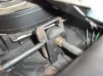

I have a John Deere Pellet stove which for all purposes is really a St. Croix Prescott and have noticed lately that the shaker plate has been a problem either getting it out or getting it in. For the winter it was easy and sat nicely on top of that rod. Today I couldn't get it to sit on that plate properly and noticed a lot of ash sitting in the pot before I cleaned it. When I opened up the side I saw that the ash grate motor had a screw out and that the motor was sitting crooked. So I screwed it back in place with the cam sitting inside the cage weldment. Talk about a round plug in a square hole!! When I turned the stove back on and watched it I realized that the cam is oval and moves around that square hole moving that rod in and out.
The question I want to know is, was this the correct way to fix it? See photo.
