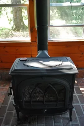

My Hearthsone is installed with a 100% vertical chimney right out of the top of the stove. This methos is ideal and much sought after. I would avoid anything else if the vertical job is possible.
100% vertical gives two options: Remove the single baffle plate from the stove and run the brush down the chimney into the firebox. Or unhook the interior double wall from the stove, slip the telescoping section together about a foot, put a bag under the bottom, and brush into the bag.
The stove itself doesn't need to be brushed. When you slip the interior double wall section together you could suck out any junk setting just inside the stove.

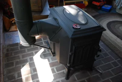

Here is what my Oslo looks like with a rear exit flue and tee.
I would consider putting a tee in with a rear exit flue, only if the following applies to your installation:
you clean your own pipe and dont want to disconnect anything
you have rear clearance issues from combustibles and dont want to use a heatshield
you want the stove too stick out further on the hearth
Just my 2 cents
