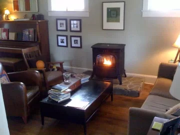

I just had my first pellet stove installed today -- a Harman XXV!
I'm so excited. In reading around on here it sounds like people leave their pellet stoves on all the time in the cold months. I guess I'm just looking for confirmation about that, since it makes me slightly nervous if I leave for hours on end, but I'm sure it's fine if I keep up on the cleaning of it, etc. Is this the standard procedure?
Here's a photo of my new install (and homemade hearthpad)!

Sit in front of your stove, read the manual, and get to know your stove. Hand over hand each circut and system and I assure you that you will soon realize that any fears you have on letting it run 24/7 will quickly fade away. It is said over and over that 99% of the problems with pellet stoves are due to the lack of cleaning and maintenance. Simply put, you take care of your stove and it will take care of you. Ensure you have smoke detectors and carbon monixide alarms installed and that they are operational. Congrats and enjoy your new stove!
I do use mine 24/7 during the heating season. Great stove you got there. Enjoy it, love it and do your maintainence on it as per the directions
These stoves are built to run 24-7. If you use clean dry fuel and clean the stove when you are supposed to you will have no problems. We have been heating using corn for 6 seasons now and had very few problems. Just do the required cleaning etc and you will be good. The stove is very safe. When was the last time you heard of a pellet or corn stove blowing up a house??

Agree, burn that thing 24/7 and keep up with the cleaning. The last time i heard (last heating season) of a pellet stove issue was a house not to far from me burning down to the ground (not blowing up) lol! They had some things to close to the stove that eventually caught fire and went up the curtains... Respect the stove and its clearances/requirments and it should do you well.
