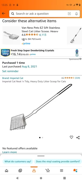

I use a metal kitty poop scooper to scoop coals and deposit them in a corner so I can shovel out the ashes.
It's your choice whether scooping out coals (wood that you processed) is wasteful...

@stoveliker, I have been using an antique coal scooper but it doesn't work too well. I'll be buying the cat litter scooper. Looks like it has much finer mesh to it than my scoop. Thanks...
