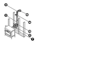

there is not a flapper cap avalible from any of the pellet pipe manufactures that i know of. It would put backpressure on the combustion blower and cause problems in the long run, doing what hearthtools is suggesting is that going verticle will create some chimney effect, which would suck air out of the stove when not in use, instead of letting cold air in.

you need at least 5' to creat positive draft out the stack.
Or you have a very negative pressure home, and its using the stove as a vent, in which case, the verticle wont help.
Min of 5 feet up after you go out the wall.
This will help keep smoke from backing into the home WHEN the power goes out.
and the stove will draft better.

Every install is unique. If your house is super tight then it could be using the stove for make up air for the house, in which case no resonable amount of pipe on a pellet stove will solve. You might have to install a outside air kit to fix that problem. If your sure thats not the problem, the solution that hearthtools suggests should work.
