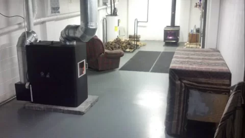

Here is a shot of mine.

Gio said:It looks like two round ducts coming off the rear of the stove or am I not seeing it right?
I want to duct straight up?
DexterDay said:Gio said:It looks like two round ducts coming off the rear of the stove or am I not seeing it right?
Looks that way.. But you just have to install 90°'s right off the back of the stove. Then they will go straight up.... It looks like it just restricts some of the airflow from the front Main vent. Some air is still allowed to escape out of the front. To help heat the space the stove is in also.
The Eco-65 is the same way. Although the duct kit is located on the front/top of stove. But air is still released into rhe room the stove is in...
Along with the radiant heat, that bit of air should keep the downstairs warm and the ducts will take care of the main floor. With no return, the basement has to be heated anyways. Its inevitable.
