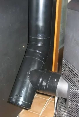

Just finally getting ready for my install in the basement:
-appliance adapter on the exhaust pipe
-then tee clean out
-then 1 piece of 5 feet of 3" pipe going up and through the drop tile
-then a one footer of 3" pipe
-then 90 degree elbow
-then a couple foot of 3" pipe going out
-then finally the horizontal cap
the instructions in the Santa Fe manual mention to put silicone for the appliance adapter to the exhaust pipe, what about from there to the tee clean out and then on the other connections?, the dura vent pipe has a little twist lock at the end and am wondering if I need high temp silicone anywhere or screws for that matter as well.
I'm using duravent and planning to cement each joint but no screws; I don't think its needed.
I have duravent on both stoves and everything is sealed with high temp sealer
except for the Tee. Going on the 4th year with my XXV and no leaks yet.
EDIT: Pipes are only twisted together and sealed, no screws were needed
IMO, you should put 3 sheet metal screws into the appliance adapter where it slides onto the stove exhaust......makes the rest of the pipe install nice & rigid. That's what I did on my Astoria.

I did not use screws with my install either, just twist lock with high temp goo. I do have to seal the end of the T joint or I will leak smells into the house.
