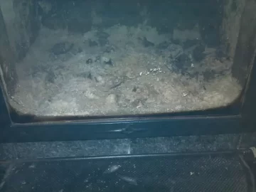

Like the above poster said, it looks pretty typical.
the dollar bill test is for the door, not the glass.
for the glass you could do a leak test by getting the fire going and tracing the glass edge w/ smoke to see if there is any room air infiltration
It's always like this along the bottom. View attachment 63246
