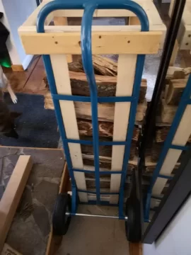

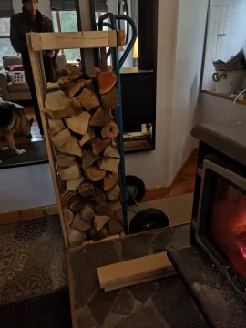

My own take on the wood cart.
39$ Dolly from Canadian Tire.
2 - (2x3) Top Bottom Plate
2 - Strapping 8ft
2.5" screws and 1 1/4" screws.
Cut 2x3 into 4 - 18" and 5 - 10.5"
Assemble top and bottom.
Bottom outter's are inset 1.5" and an extra middle piece. 2.5" screws
Top is simple square frame.
Cut strapping to 4 - 4' pieces. (you will need an extra 18" piece of strapping)
Inset the strapping that will sit inside the dolly's frame rail. attach with 1.25" screws to boxes.
Front are a bit farther apart.
Then take the 18" strapping and sandwich the frame rail to the upper box. 2.5" screws.

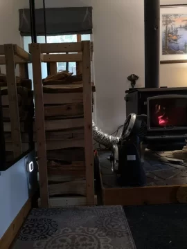

![DIY - Wood Cart DIY - Wood Cart](https://www.hearth.com/talk/data/attachments/232/232179-897d03d481172ce2e7e32cf007636515.jpg)
You are welcome internet. :D
You could take your time and if you have the room, encase in pallet wood and stain.
It's funny. At first I was all about appearance. Wood in a copper tub. Cutesy. Now it's all about the least amount of effort and the most amount of wood I can get into the house in 1 trip.
The house can be nice looking in the summer.
2 - Strapping 8ft
![DIY - Wood Cart DIY - Wood Cart](https://www.hearth.com/talk/data/attachments/232/232177-e971f6c2b46bc7fa14c8b5f446c99316.jpg)
![DIY - Wood Cart DIY - Wood Cart](https://www.hearth.com/talk/data/attachments/232/232178-16ee294f9923f2d08be59b28293c358f.jpg)
