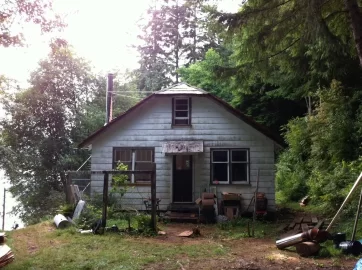

I'm thinking of insulating the cabin (attic ceiling and beneath the first floor - there is no crawlspace or basement, just open space under the house - it sits on log skids). There is currently some sort of 1950s rockwool (gyproc brand I think) in at least some of the walls, but no other insulation anywhere.
I think I'll do between the floor joists with Roxul (to prevent mice issues in fibreglass), but I am puzzled over the attic. There is living space up there, so I would like to insulate between the rafters in the attic ceiling. There are no soffits or ridge vents, and each end is hipped, so I think I need to insulate it as a 'hot roof'. In order to do this and deal with moisture issues, I think I need at least R20 of spray foam or rigid foam boards because we're in zone 5. We're on an island so getting a spray foam contractor out will be $$$, but cutting 4 or 5 inches worth of 2' wide rigid foam boards to fit between 24"OC rafters sounds like a nightmare. Has anyone ever tried a DIY spray foam kit like here: http://tigerfoam.ca/? Seems kind of dodgy to me.

Pic for an idea of the layout:
