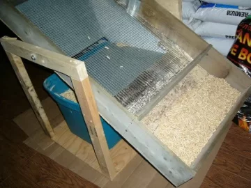

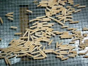

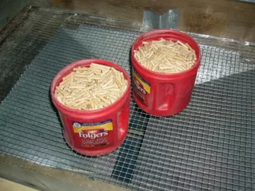

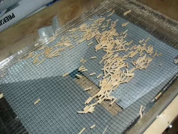

i've wrongly ordered 225 bags of pellets that are long. returning would have been the first choice but handling them by myself a second time was not in the cards! jamming the hopper is not a wanted situation during the required heating season so i made a diy sifter(screener) for my extra long pellet supply. here some pics of the set-up and the amount of long pellets removed from each bag from the manufacturing culprit. i hope the pics work.....
