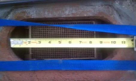

I just purchased an older wood stove fireplace insert. The top has a rectangle oval shape and I havent been able to find the exact part I want to use. My chimney liner is 6" flex.
My question is this: I want to use galvanized stainless steel flashing around the top to connect the stove to the chimney liner. I know it is not ideal, but is it acceptable, or will I putting out a fire in the near future? I planned to seal the top with screws and putty for high temperatures.
The blue straps in the pic are just holding the stove to a dolly.
