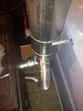

X2, I agree 100% but I have pre-heated OAK air from the outside using Selkirk DT. There is no better more efficient solution by far!
Click pic to Enlarge
  • [Hearth.com] Disconnected OAK?
