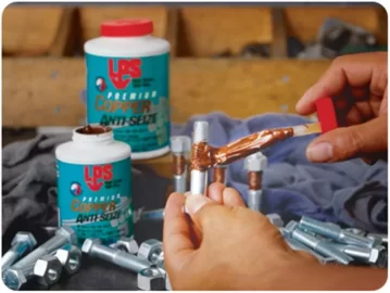

I don't think its a problem and i would also thjink you will have to clean it more often. Did you lube the cam and the front bnushing? Maybe a bit of spray on the motor shaft? What model stove is it?
It' s the St. Croix Hastings. I didnt lube it. What high temp lube do you guys recommend and where can I get it?
This quieted the noise my quad made when auto cleaning.
