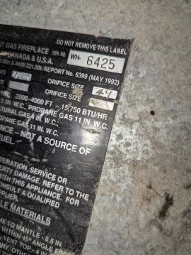

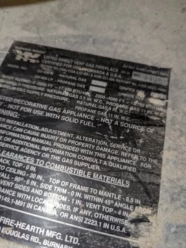

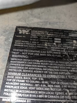

The other fireplace has a closed box and vents sideways outside the wall. However the label underneath the fire box says "Not a Source of Heat"
Is this possible? If I want heat from it, do I need to replace it? I thought Direct Vent fireplaces were to give you heat.
