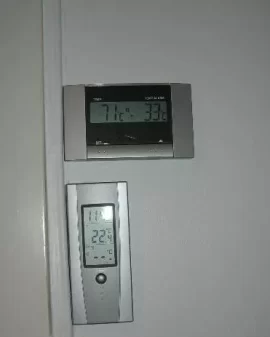

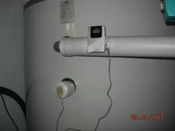

I use a digital roast termometer.Its a non wire thing and cost noting.
But thats maby not what you asking for
