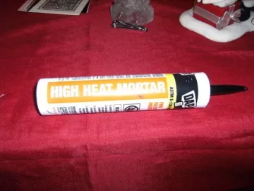

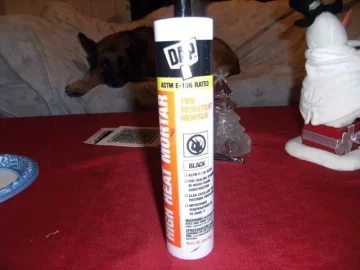

This stuff worked well for me,
DAP High Heat mortar (ASTM E-136 Rated) Resistant to 2000Deg F.. Got it at Lowes, the HD by me has the same in Rutland brand. I found this stuff to be much better than the furnace cement in the big tub.. It cures rock hard with heat applied and stays firm even with some expansion and contraction. For me the furnace cement cracked and fell apart around the flue collar, this stuff is holding well after 2 months..

That is what we are going to do. I have a tube of Harvey's furnace cement that I had forgot I had down in the basement! It is good to 3000F. I had used some before many years ago when sealing around a new exhaust pipe for hot water tank. We have been running small fires in the stove to cure the brick; nothing seems to be hotter than around 350F. Hopefully that will allow us to get the silicone out of there a little easier after a few more of these hot/cold cycles and put in the furnace cement. Overall still happy with the Napoleaon but the control mech for the blower was not installed very well, it has a lot of slop when they put the nut on to secure it to the unit.
