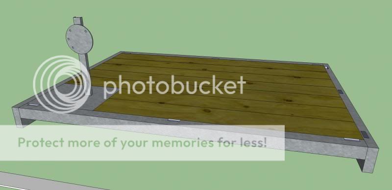

I need a better bed for my truck. I've beefed up the rear springs and the brakes (upgraded to Toyota T-100 discs/calipers in the front), but you can only carry so much in a 6.5' bed that doesn't have very high sides. So I decided to build a flatbed. The bed will be about 7' 6" which is kind of long, but it will be mounted up high so I shouldn't have any departure angle problems. I'm going to make it 63" wide which is basically as wide as the widest part of the cab so that I have as large a bed as possible.

I'm going keep the spare right behind the cab old school style-that way it's up out of the muck and easy to get to. Plus I'll still be able to carry 4 x 8 sheets of plywood to the right of the spare mount (4' 2" to the edge of the bed). I'll also be cutting in stake pockets so that I can put 24" tall stake sides on the sides and rear. I should be able to carry a decent heaped load of wood that way.

The bed itself with all of the steel, 3/4" oak decking, and the spare tire (265/75/16 Treadwright Guard Dog on a 16x7 Tundra steel wheel) should come in at just over 500lbs which from what I've seen is about 200lbs heavier than stock, but I have 200lb helper springs on my rearend that can handle quite a bit of weight. I'm hopefully going to be making a deal on some 5.71 gears I found on Craigslist later this week so those will help get the load moving. I'm going to make my own mounts out of UHMW polyethylene-that's what a lot of better body lift kits use so it should work well. Eventually I'll add a backrack because I need a place to mount a high lift jack, chainsaw, and some other stuff, but I just want to get the basic bed built for now. Hopefully will be starting on it soon.
