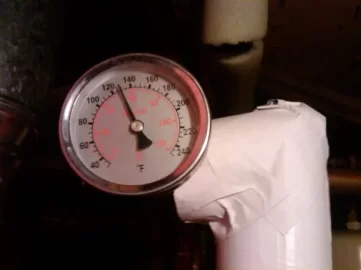

I set my DHW tank to 130 degrees. Any lower and my wife complains! I could get by with 120 Degrees fine!
To keep a good eye on it, I installed a temperature guage. See pic below!!

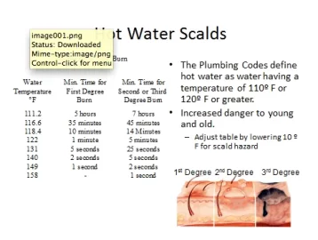

Two issues, one being the growth of bacteria. For that most experts suggest the tank be run to 140F or more for at least 1 hour per day. That temperature has become a requirement in some areas.
But that is much too hot to send out to the faucets and showers. The best solution is to add a quality thermostatic mixing valve at the tank. 115- 120F seems to be the temperature most agree on. In some cases plumbers will run a separate high temperature hot to the dishwasher and maybe wash machine. Soaps work best with hot water.
The thermostatic mixing valve you choose should have the proper listing to assure code compliance. An ASSE 1017 goes at the water heater as a point of distribution valve. A 1070 would be a point of use valve at the sink or shower. A 1070 valve cannot be adjusted above 120F, by design. Most shower valves are available with some sort of scald protection either temperature, pressure or both.
Thermostatic mixing valves are a must on solar water heaters and indirect tanks that have the potential to reach high temperatures either through over heat protection functions, or improper piping from misplaced or omitted check valves, etc. Scalding can and does lead to deaths too frequently especially with infants and the elderly.
Remember mixing valves will require some cleaning and maintenance depending on how hard your water is and how much flows through it. Install them with isolating valves so you can remove the cartridge and soak it in vinegar or de-limer from time to time.
