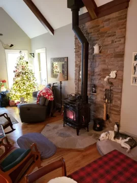

Maybe not exactly what you are looking for but here's what we did with our new build. The original plans called for the fireplace be at end of room (just left of the Christmas tree). I moved the stove to this location which is more central to the house, open floor plan that includes kitchen, dining and living room and two story. I have 14 ft ceilings here but only 10 ft where stove pipe meets ceiling. Kept the stone look but chose efficiency in heating with free standing wood stove. In my climate, this little stove heats over 2,4,00 sq ft.

Nice looking install and a very contented pup. I hope Regency brings the Hampton stoves back. They are good heaters.
BG, this stove is very good heater, well built and enamel finish is top notch. Although I don't have any experience with other epa stoves, I'd would recommend this unit. I have burned this stove for 3 years now and there has been a learning curve as with any new stove. It throws out amazing heat and can go up to 8 hours between loads and have an easy restart. The stove is pup approved as well. Maybe the Hampton line will come back.
