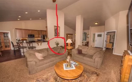

Another idea we had was to use the dining as is and put the stove next to the kitchen in the nook against the east wall. I envision a couple rocking chairs next to the stove in the nook such that people can sit next to the fire and talk to someone else either in the kitchen or island. I most likely will keep a weeks worth of wood on the back porch so it would be easy to bring in wood to that spot.
Keep close to the center, both for heat distribution, and less chimney sticking out of the roof.
