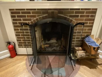

My wife and I live in a small house (single floor, about 1000 sq ft), built in 1930, with a large centrally located chimney. We love to sit by a roaring fire in the winter, but between the inefficiency and the noticeable drop in indoor air quality we've decided it's time for an upgrade.
What I'm struggling with is figuring out what kind of hearth (stove in the current fireplace vs insert) and heat output is right for our house. Most of the posts I've seen are by people with houses twice our size, or with a chimney on an external wall, or with a freestanding stove with no masonry. And most have multiple floors! Our house's insulation is pretty mediocre, but we plan to upgrade it sometime in the next year when we convert from baseboard and window units to a heat pump.
Our highest priority is a pleasant fire in the living room, though I would love to be able to shut off our heat and let the hearth keep the house warm overnight if that was possible. We do lose power from time to time and it would be nice to have a backup. On the other hand, I want to avoid radiating so much heat that the room is unpleasant.
Here's some photos of our current fireplace, with an opening that is 32" W x 30" H x 19" D

Any thoughts? Or professionals we should talk to? We're located in the Hudson Valley, about an hour north of New York City.
