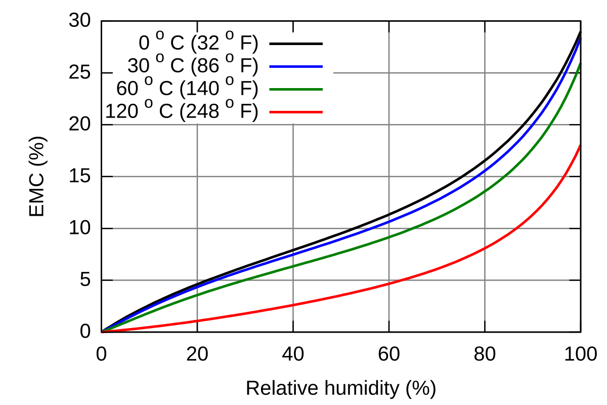

As stoveliker alluded, your "25% per year" estimate is based on an intuitive linear interpolation. It's likely to look more like exponential decay. So if you dry it for 2 years, 2/3 of the drying may occur in the first half.
Here's another good source on your expected final percentage:
