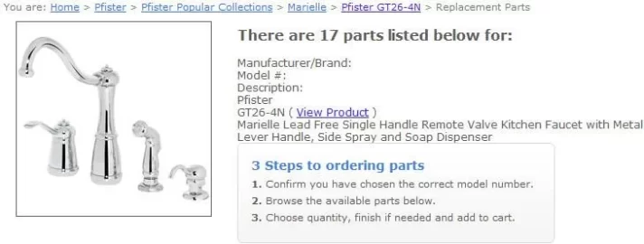

Just found out the faucet is a Price Pfister brand. Sprayer Part ref # 951-026
From PP website
http://www.pfisterfaucets.com/partsonline/index.aspx
Pfister product parts can be purchased from our partner's website, Faucet Direct. Part purchases are subject to Faucet Direct’s policies and terms and conditions.
http://pfisterparts.faucetdirect.com/index.cfm
Single handle faucets
http://pfisterparts.faucetdirect.com/price-pfister-single-handle-kitchen-faucet/c17149
Looks like this is the faucet Pfister GT26-4N!
http://pfisterparts.faucetdirect.co...isplay&productId=GT26-4N&manufacturer=Pfister
See pics
