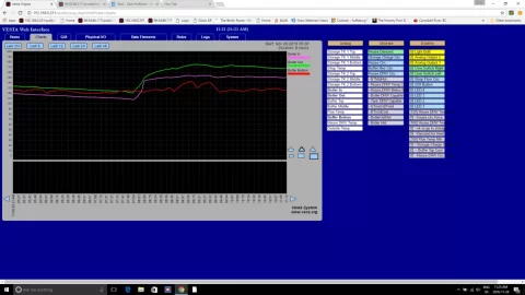

I have a 140::F danfoss boiler protection valve , it always seems to send 150::F water to boiler anybody else have the same issue with theirs? Thinking of trying a 130::F thermistat if they make one.

Not sure if you can make out the temps on that graph Fred. If you can, u will see that once the boiler in temps reach 150f or higher, that it is around 10 degrees higher than the buffer bottom temp. "Buffer bottom" temp is the temp the water enters the danfoss and "boiler in" temp is the temp after the danfoss. You would think that if the danfoss is fully closed that there would be no mixing with the boiler out water and the temp would be the same on both sides of the danfoss.
