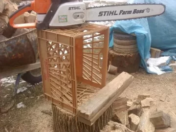

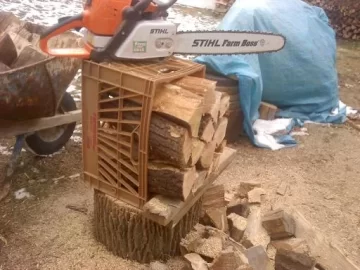

i bought some wood and there was about 30 peices too long...whats the safest way to cut off the ends with a chainsaw?..
wood-fan-atic said:Stump - milk crate - 2x4 - a few drywall screws to secure crate & 2x4 -- Ms 290 w/ 20" bar does the rest
