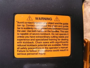

Top of cylinder cover on my Poulan 475,good advice to follow every day no matter what size saw you own or operate....
