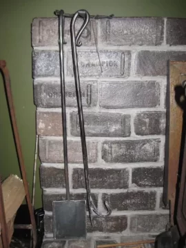

as an amature blacksmith with access to all things steel I make all of my tools, and my friends tools, and some oftheir friend tools, and some for family members, and some of their friends, and....
Seems once people see a set of custom tools they all want them. If I charged them for my labor either they cold not afford it or it would not be fun anymore. I make custom kitchen and hunting knives too. Just a hobby.
I have a coal rake planned in my mind. Just have to find time to get to the shop and knock it out. I also thought about making another shovel with an expanded metal bottom like mentioned above for separating coals from ash.
Not a great pic but best I have of my set at the moment

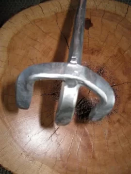

This ash rake is made out of a 3x5 piece of aluminum that came with a radio shack project box. It put a 90 degree bend in it and attached it to a piece of aluminum square channel I had laying around. It doesn't hold heat and is great to move coals around on reloads. I use this much more than the poker.

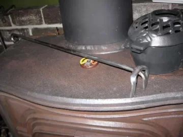

A rake I just fabbed at the forge I thought I would post here. have not had a chance to test drive it yet because it is 80+ degees here in Mid-Michigan
